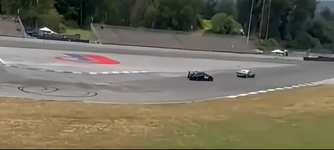

What you have is bad roll couple. Either spring rates front to back are off or roll bars are not matched. Try a 15/16" roll bar in front with no bar in the rear. F41 springs in front and back should get you in the ball park. I have some old F41 front springs if you want them. Sell them cheap.
thanks, but the suspension is from a C5 Corvette in the front and a 5th gen Camaro in the rear.
Are you happy/comfortable with the toe control geometry of the Camaro suspension?
I had an exact opposite issue (understeer/difficulty getting the car to rotate in the turns) with my car, I changed the length/position of the rear toe links, and got the neutral handling I was looking for.
As always, YMMV.
if nothing else, at least it got my rear tires warmer.... 2 choices, either the rumble strip upset the apple cart or there was something on the track....

I have concerns about the camber of the left rear wheel from this picture

One thing you may want to look at is bump steer in the rear suspension. With an IRS with toe links, raising or lowering the outboard end of the toe link changes the bump steer characteristics, just as changing caster on the front suspension does. Using the C7 as an example, rear caster set to 0 degrees is critical in preventing unwanted bump steer characteristics. I don't know what the caster of the Camaro suspension should be, but you could bump steer the rear suspension just like you would the front, or you could map all the pick-up points and run them through a suspension analyzer. If you are introducing bump steer (on one side or another, or both), that could cause toe-out under compression that could cause a snap oversteer. Just sayin'
so the pictures weren't lying, the camber on the rear is substantially different right to left. The question is only 'which moved' I think it's the left rear. Last year, I had trouble with the alignment cams on the front - so I replaced everything to eliminate them and replace them with stacked shims. The front seems to be just fine now. Of course, the problem travelled to the next weak link. I've ordered near lower control arms that eliminate the cams.
and I agree - the alignment was not static, and when the lower arm moved, that changed the rear toe as well. I guess the bright side in all of this is I'm going to wait before I change to double adjustable shocks. the pictures also showed me that with the shocks properly set, the car maintains good balance in the turns. Not saying I'd turn down a sponsorship but I'm not going to sponsor them myself until I get this latest fix installed (end of August)
