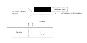

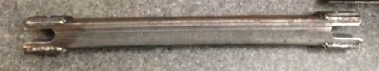

Strength and design question
I installed the rack and pinion that you have here on the site. AWESOME BTW! I wanted to redesign this bracket to look better so do you think this will work? The original bar is 1.5" x 1.5" at 1/8" thick. The new is 1x1x1/8 but the difference will be the ends as shown in the picture. I feel it will work better with less issues... I never done anything like this so your comments are really important to me.

I'd opt to add a piece of metal below the folded sections (and top maybe too) to give you a box section - with those "fingers" the folds -might "fold" under load even though the total section width is 1/4 inch at the ends. Just me.

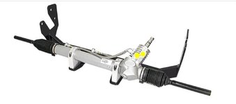

I finally got my Flaming River Rack N Pinion completely installed with my power steering. WOW, so much better than what I was expecting. I just backed it up into my driveway and back in the garage but it was really easy. I have to make a couple adjustments to the alignment of the power steering pully and I need a 90 degree fitting to smooth out the line.
A pick of the Installed Rack would be appreciated. I have the Steeroids and am not happy with the cobbled together mount I'm working.
You may have a better idea? Guessing it is set up for rear-steer?
Thanks in advance - Jim
I'll get into it tonight for pictures. Here is the manual though. It's a pretty easy install but $$$. It's a solid unit and worth the money, at least to me. I believe they will send you the power steering pump line kit if you buy the RnP. I installed a specific type II power steering pump with a reservoir but I ordered a couple of 90 degree fittings to route the lines better and you need a specific flow reducer that works with the RnP. I'll get the part numbers as soon as I get it completed.
