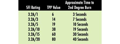

1. Minimum get a SFI 3.2A/5 Double Layer Suit - gives 10 seconds (when new) exit time.
Your minimum exit time should be 5 seconds - they may want to check this when car is certified.
Factor in time to stop, car damage, etc. -- it could get painful.
