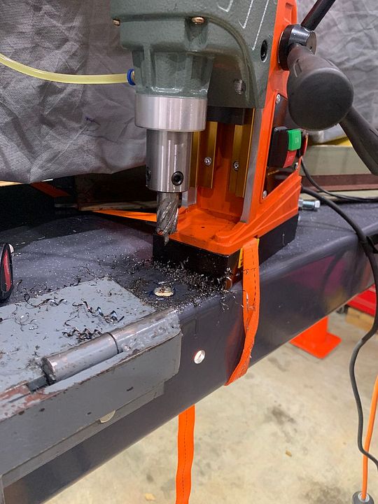

Ok let’s keep going. My grade 8 5/8 dia bolts came the other day and the vevor mag drill today it has a magnetic base and uses Weldon bits
Let’s drill some holes and mock it up. , let’s drill some witness marks in case the tape gets ripped off( it didn’t)
Lots of holes for a variety of clamping options but I have only 10 bolts
Give me lots of space, use a cutting oil , it self feeds the cutting oil and I used about 3/4 ounce
The twist drill chuck is interesting it uses a tapered shaft
Took about 25 minutes to drill those 19 holes

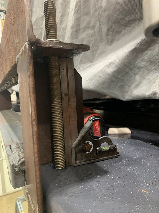

Now drill the hole to mount it on the ramp
And next effort will be tacking down the nuts to the clamping bar
Now we weld the nuts in place, put them on a bolt to grind the sides to shiny metal, hold them in place on a bolt and weld the flats
Only thing I may do next time is to clamp a bar across the back so spacing is uniform

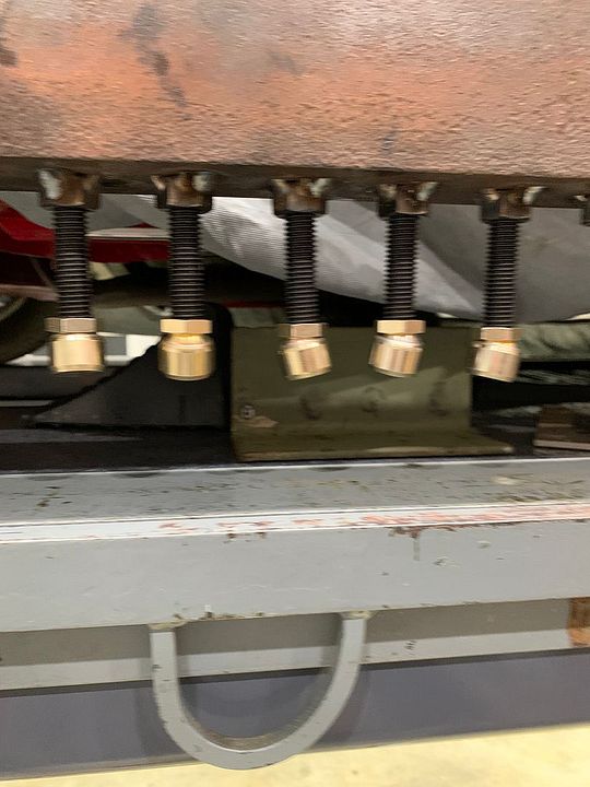

I think I will use copper pipe caps with green sticky grease in them on the end of the bolts

How do you like your vevor mag drill? They seem to be priced better than most.
I bought it for this project $169, free shipping and ten. Weldon shaft cutters, those (19) 5/8 holes took 25 mins to drill, self lubricating. I love it and was too late to this party
They have two cutter designs the Weldon shaft with two flat spots or a quick release “Noki” or something like that cutter. Those quick release cutters are really expensive.
Let me find the Black Friday link
This is the one but the 25% discount isn’t applying for some reason
Thanks, it looked like it did a good job on your brake, but thought I better ask.
The 25% discount is back now, the self lubricating is pretty cool it uses a floating center pin that when it’s depressed the cutting fluid drips to the center of the core cutting bit, I am not sure it lubricates it self using the twist drill chuck. I like it enough I would buy it as a gift for my boys

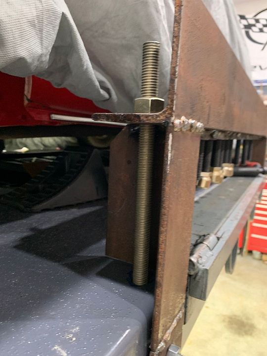

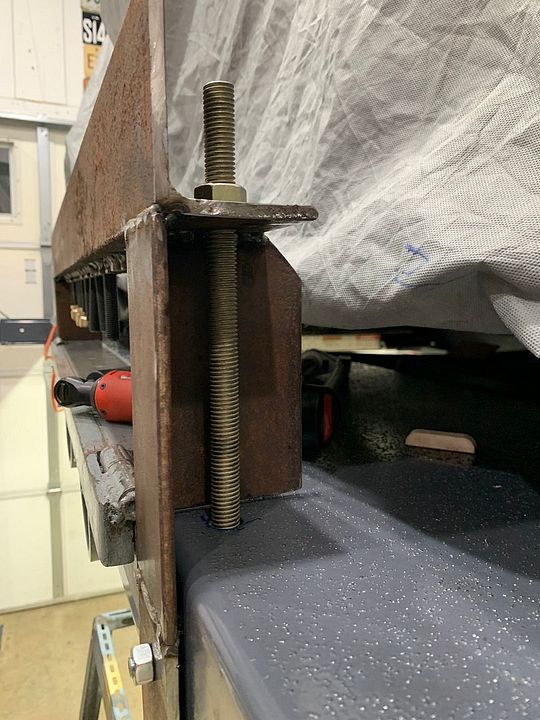

Well I had a chance to play around with the brake and I think I have done the final tweaking of it,
I added swivel tips to the clamping bolts and I added two long bolts to clamp the top bar to the ramp
