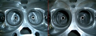

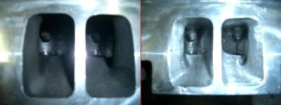

Following thi directions (from David Wizard) i did the job in my old heads:
the tools (Standard Abrasive)
some parts......
