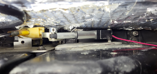

Still working on some behind the dash issues before I close it up. One of the things I have always hated about 60's cars is the hot/cold cable control. The cable is almost always bound up so it's either stuck on hot or cold or somewhere in between. And the cable is so stiff you can't really route it so that it won't bind up.
I found this tiny 2" stroke actuator that fits in there perfectly.
