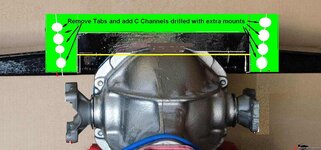

This image shows how I approached mounting to the crossmember rather than the Diff.
I built the pieces from comercially available angle ''iron." Welded 2 together ( one cut and notched as shown, and then welded to the crossmember.
Lots of weekend fiddeling with models and moving pieces around, but the results are VERY favorable (regarding Camber Change.)
