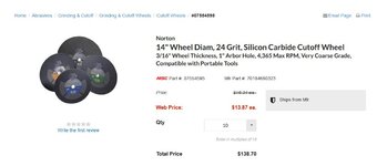

You got me thinking....have I been using the wrong blades? Over on the Miller Welding site seems the discussions are between tooth blades and abrasive - and evenly divided. I don't chop a lot, but when I do, I have been using the abrasive blades. In fact I have been using my miter saw for years as a chop saw - I gave up framing!
Here is an option that gets you 10 abrasive blades for the price of 1 toothed.

Well, I took a peek at my chop saw (3300 RPM) and my mitre saw (3700 RPM). Damn, I had no idea they were spinning that fast. I'll still take a cruise over to HD to see what additional blades they have that hopefully would work.
The abrasive blades look to be capable of high RPM, but I don't know if there's contamination issues to consider when welding any of the cut edges.
