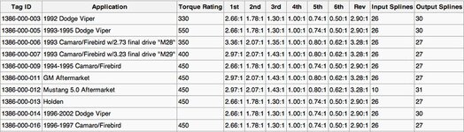

My question is, what makes the most sense? TKO/T-56/???
My understanding is that a T-56 from a 93-97 fbody is more or less a direct swap for the 700r4? Would be nice not to have to have another driveshaft done..
I have located a T-56 from a 1997 30th Anniversary Z28 including the stock clutch at a very good price.. would that be a good way to go? I plan to sell my 700r4 (which is a brand new rebuilt with shift kit) and purchase the T-56.
These are the specs I found for the 97 camaro T-56:
Screen Shot 2014-02-03 at 11.02.02 PM by bhays, on Flickr
So, would this be a good choice? What would be a better one?
LT1 T56, pretty easy to install. Make sure you get the COMPLETE thing, including the bellhousing and the slave cylinder spacer. the original 82 driveshaft should fit with that combo.
Couldn't agree more, especially since the T56 donors are becoming cheaper and cheaper..... Nowadays you can buy a entire LSx T56 donor car for less than what my TKO600 cost me..... And I have both, the TKO in my '79 and the 6spd in my C6 vert..... The 6spd is nicer.....
Unless you really want a new (new) transmission, the TKO goes for $2200 at Summit.... You could have the whole shebang new (incl bellhousing,clutch etc) for maybe $3500....
I just did the math... Dump the Super T-10 close ratio and used a ROD 6 Speed...
I get all the overall ratios I had before and picked up a streetable first gear and OD on top for those LSR runs.... LOL :beer::beer:
T56 here... Great aftermarket support, shifts way nicer than my buddies TKO600. I use 5th gear all the time, and 6th more than I would have thought- even with 3.55 gears.
6 speed turbo just sounds cooler too :amused:
