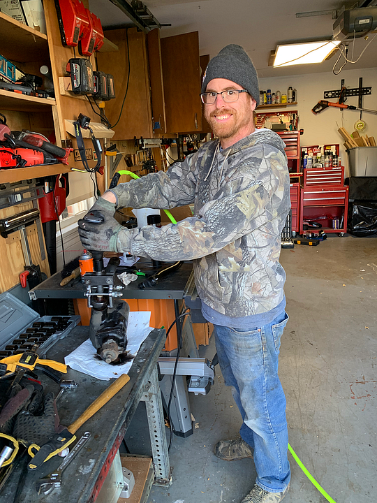

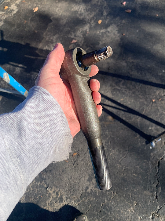

heres the first question does the end of this rebuilt Mavel steering gear look damaged from shipping or is it mushroomed from the manufacturing process? and do i need to worry about it?

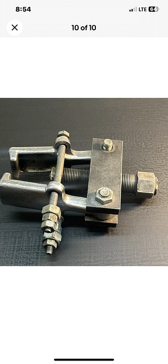

we can't wait to put this Pitman arm puller on it and have some fun, i had a bear of time on my C3 srteering gear pitman arm

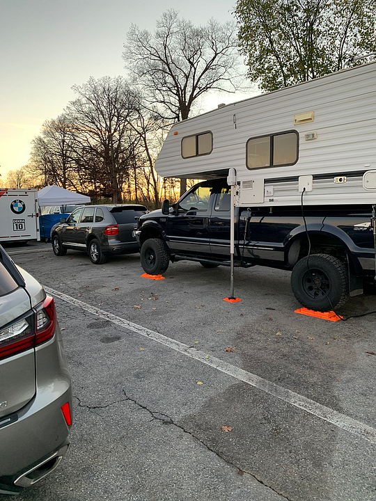

only other thing is getting the parking brake to hold the camper on an incline, we need that for boat ramps. i think the cable is really stiff from not being used and are hoping that continual use of it and some incremental adjusting of the parking brake shoes in the rotor hat will fix things. recently it had all new brakes and a parking brake hardware kit put on it.
any other thoughts on that mushroomed shaft?? i think it was mushroomed in the manufacturing process since it so evenly distributed. thanks bob
on FJ40s we cut that very top bit off to allow fitment. To me that looks like it was dropped from substantial height - as long as it still turns smoothly, I'd run it.
Is the spline pressed onto the shaft? I would really be surprised if that was a factory process (mushrooming the end).

thanks guys. my son who has it in his hand (and its his truck) wants to return it, its a no cost process with Rock auto so lets see what the next one looks like. I bought the parts for the project but its his labor, Mavel never returned my email to their customer service people.
that makes a lot of sense. no way of knowing if that was pre or post rebuild.

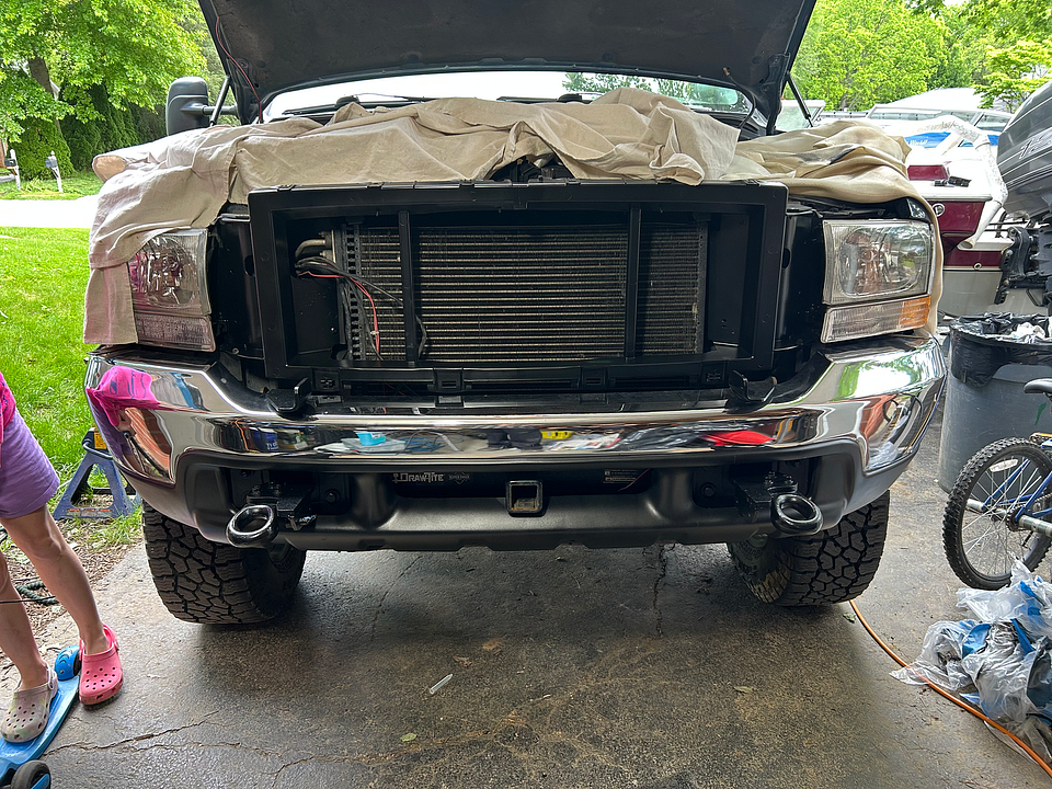

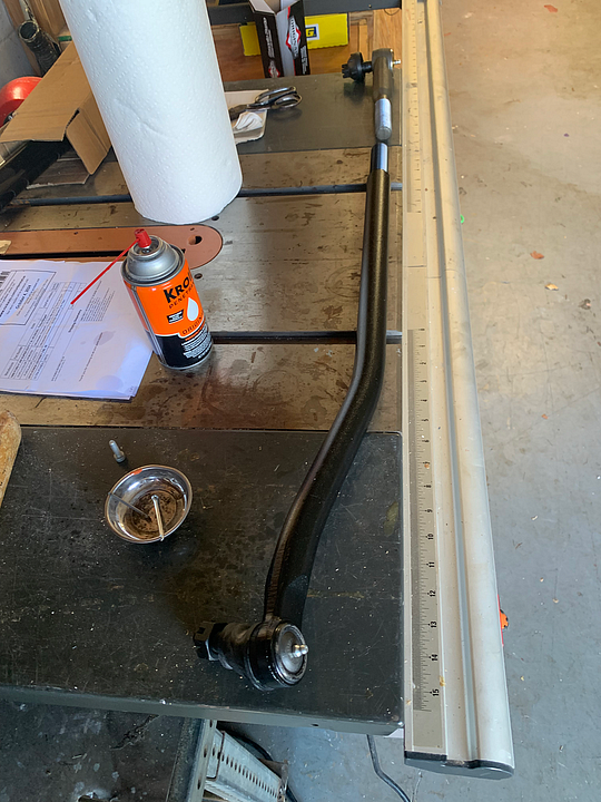

we finally got the steering gear and other parts in and we put the new steering gear in, center drag link, tie rod end and steering dampner in. we pulled the camper off so i could do some more making things shiney
next was taking lots of stuff out to get to the steering gear . those were some beefy parts and needed a serious puller for that pitman arm
and the MAC puller to make it happen, i got it off ebay and turns out my head stud nuts for the MGA are the same size as the missing one on the yoke.

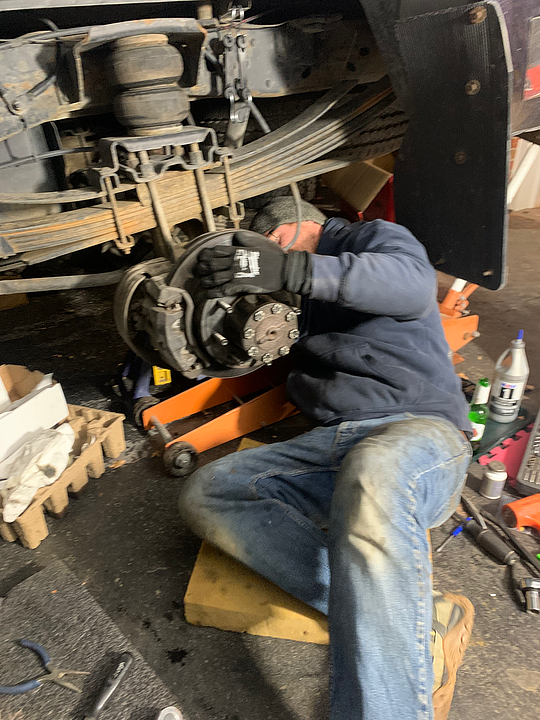

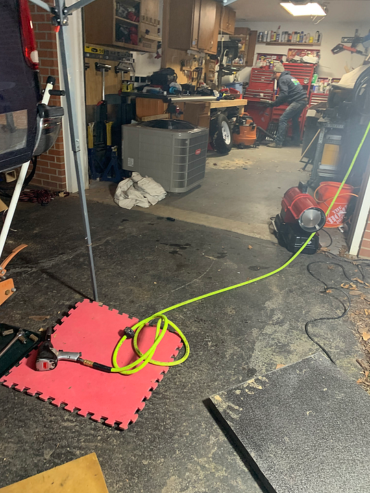

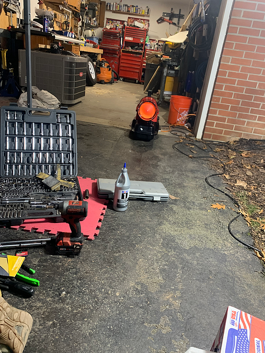

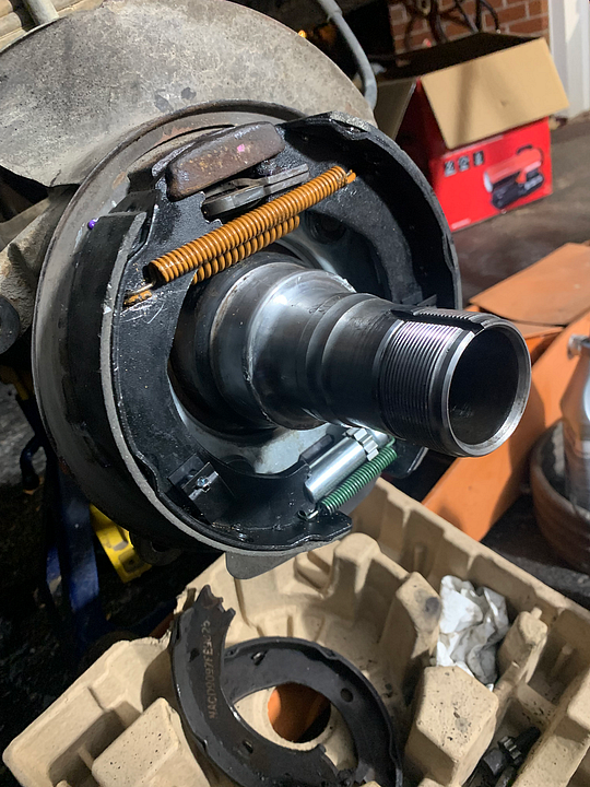

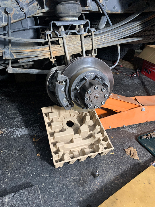

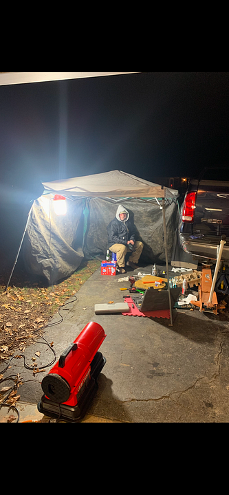

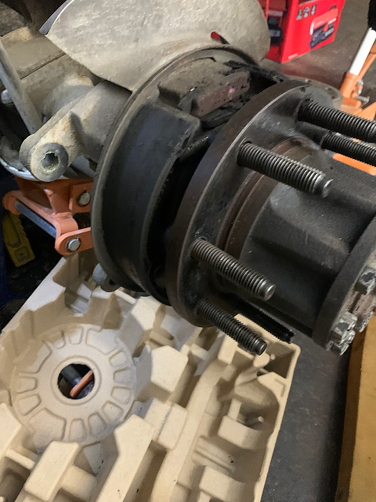

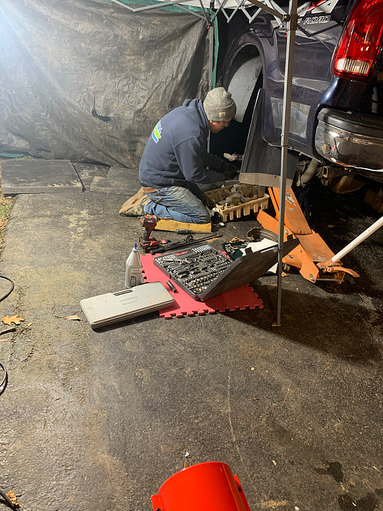

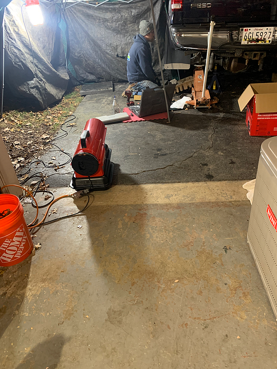

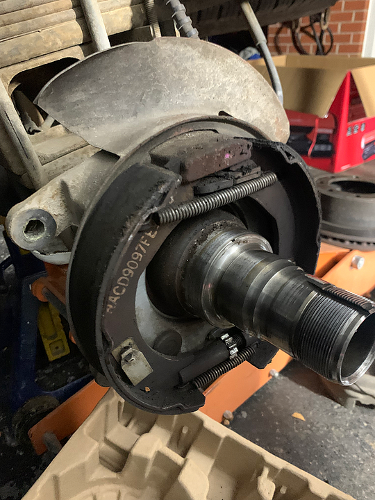

and now the last fun part. the last time my son and i did rear parking brake shoes inside of the rear hub of car with calipers and rotors was on the C3s we had. we all know what fun that is and we added a few words to the webster dictionary for sure, so we were not looking forward to this,

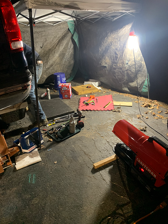

just so we are clear on this it was 24* degrees outside and night time we finished at 1:30. thats an 80,000 btu torpedo heater blowing into a canopy wrapped on two sides with a tarp bringing it to about 35*

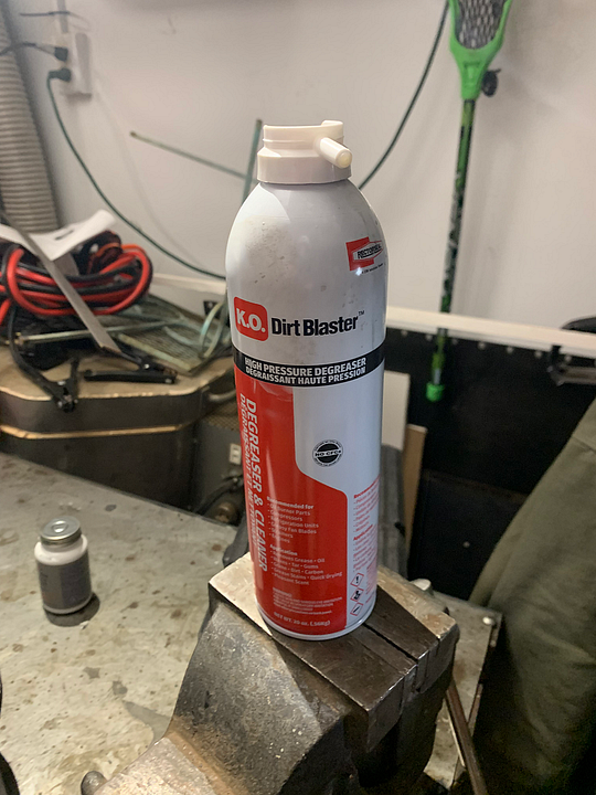

that dirt blaster product is now my favorite degreaser its freaking awesome and puts brake clean to shame, dont use it any where near paint
and that top spring must be above the inner spring with coil side up, or it hits the hub
it was freaking cold

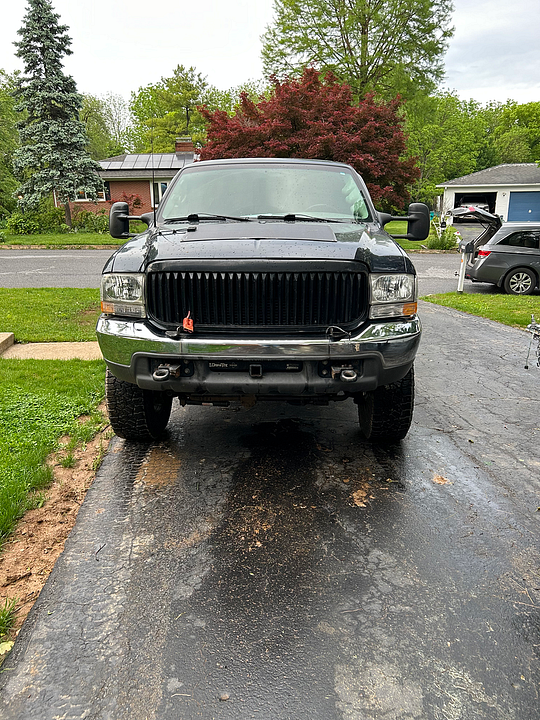

The beast needs some love, this is our ( my sons) trailer tow vehicle and camper we take to the race track.
1999 F250 superduty 4x4 7.3power stroke diesel

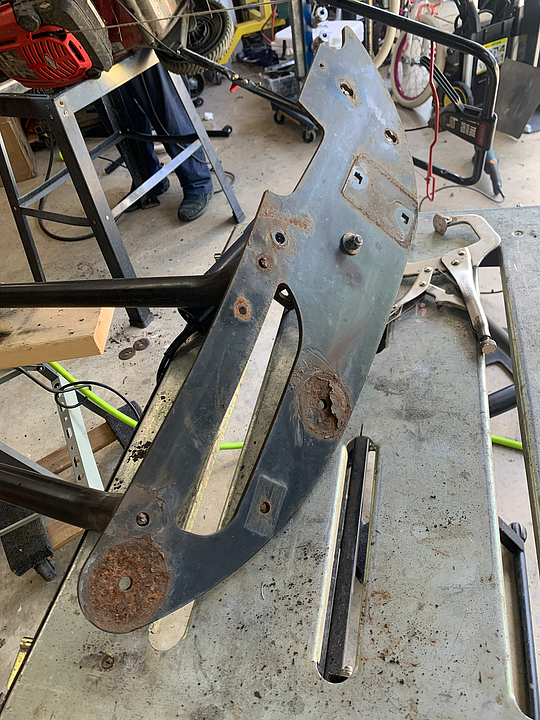

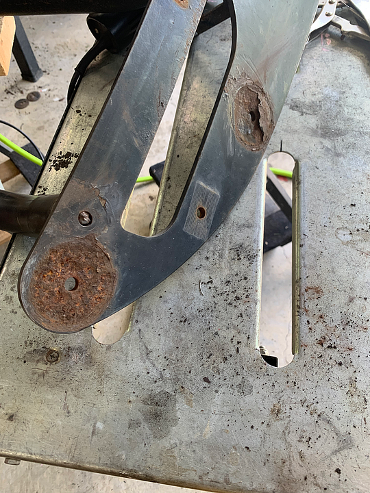

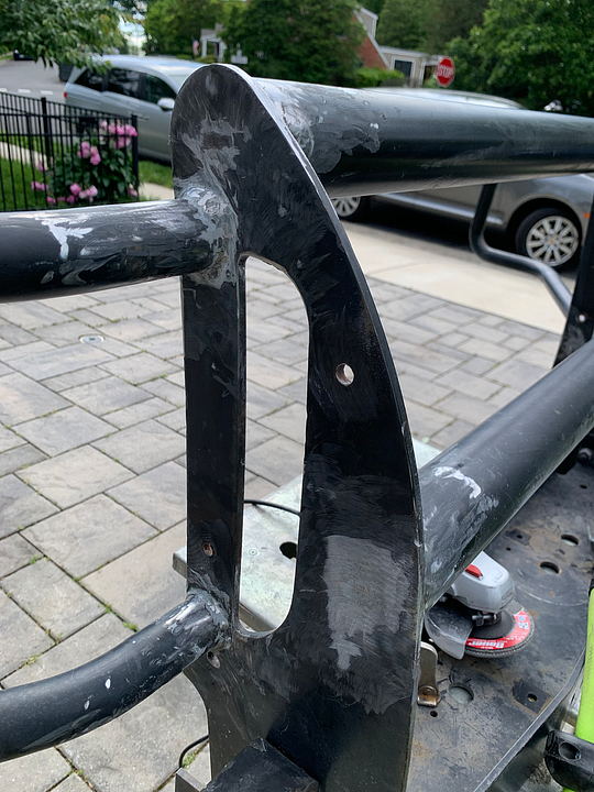

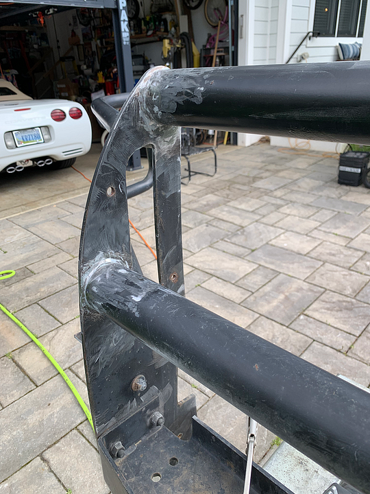

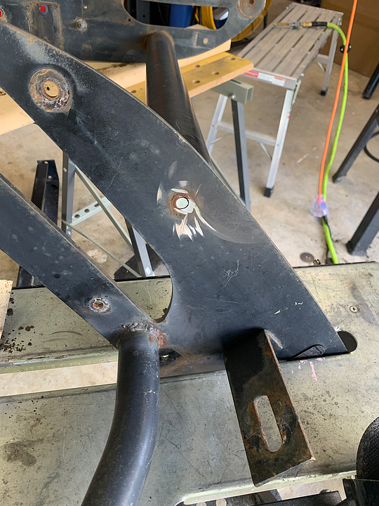

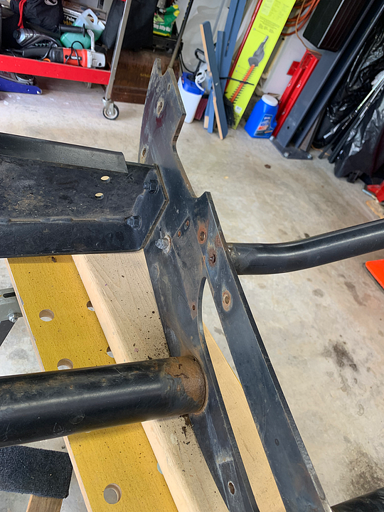

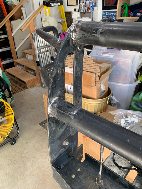

The brush guard winch mount has two tabs for mounting that have broken welds
So we are going to show it some Bob love
This is the idea, We chose option B
And the first part of making it

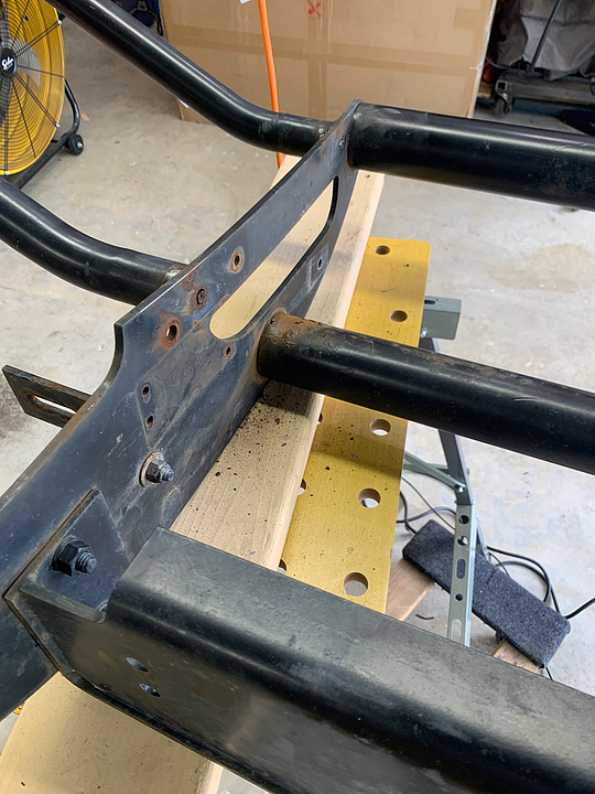

We will make the diagonal cuts in the field and decide which side of the off set cut the tab bolts up to and the final length of the bracket
Tomorrow we weld the big tubes in the middle to the side supports
Stay tuned

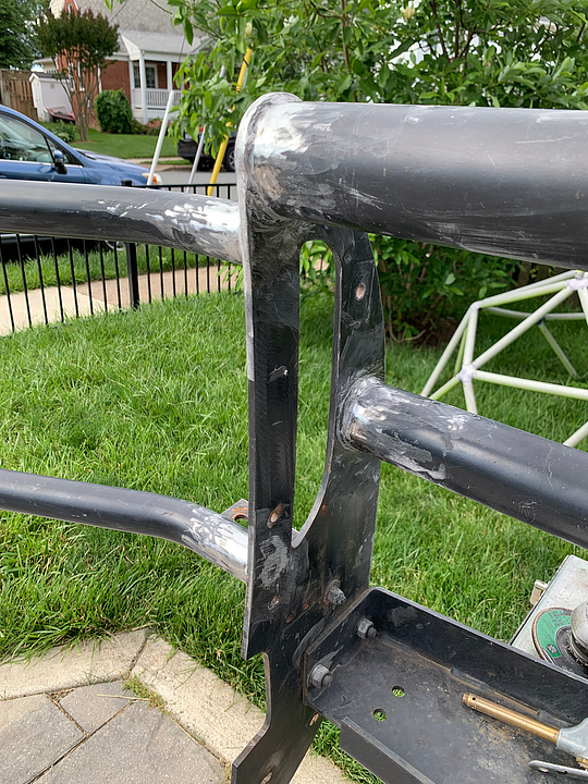

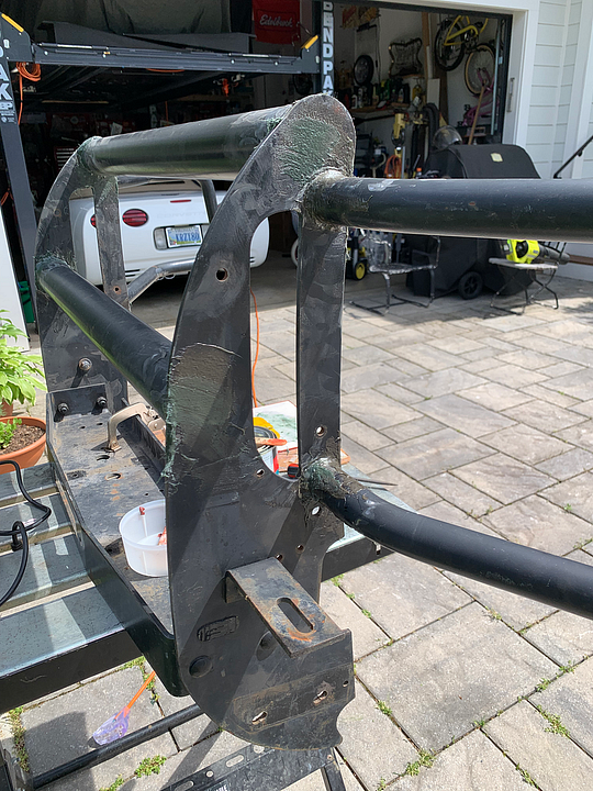

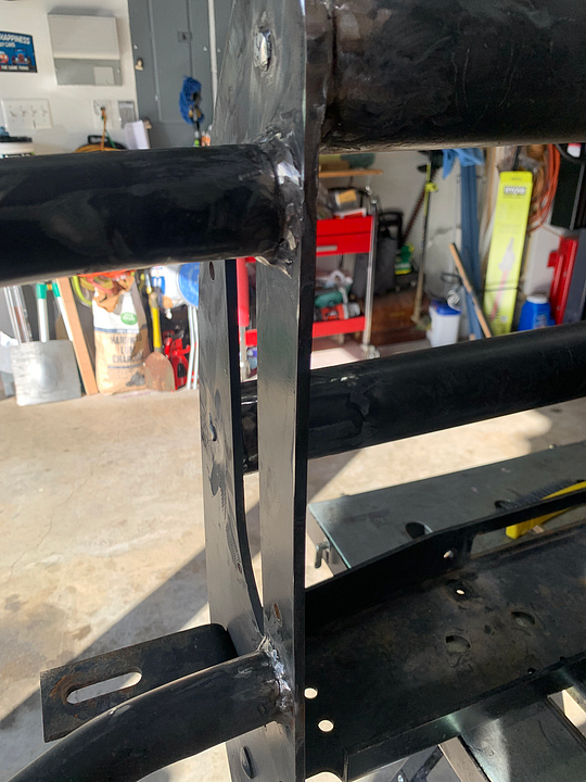

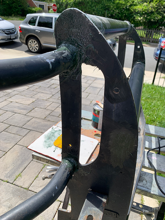

today was diiassemble , sand , weld grind weld grind, tomorrow everything gets cleaned up and fiberglass gets put on the welds to make them look pretty

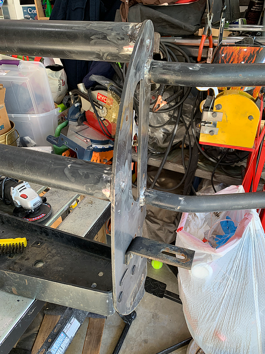

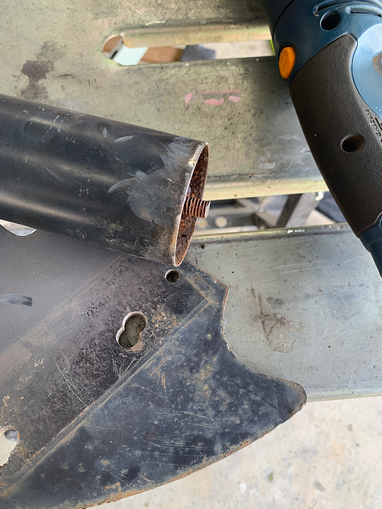

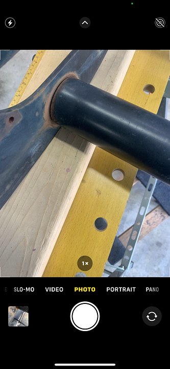

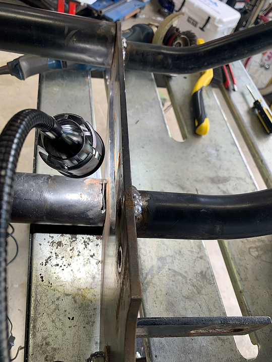

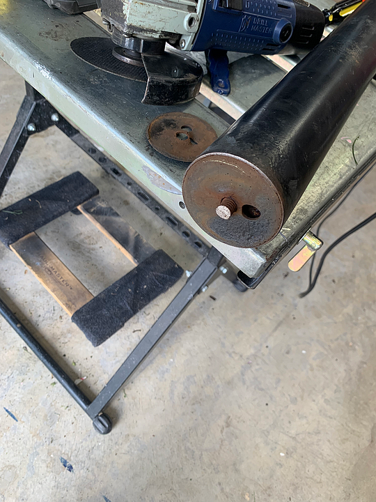

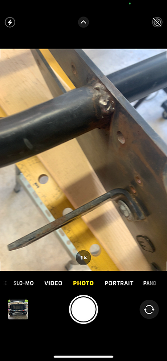

I had to take the tubes off because they had a plastic gasket in side of them, the out side tubes had previously been welded on , I ground off the nut caps and welded them in place upon reassembly.
Photos to follow
dissassemble everything to clean it up and get the plastice gasket out of the way

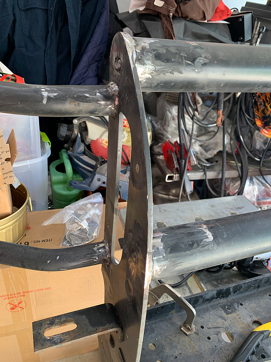

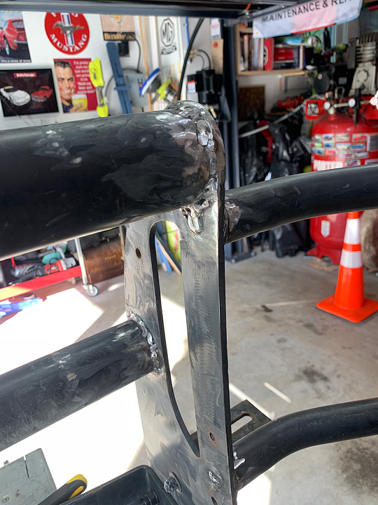

tough welding two different thicknesses and the tubes had some rusted spots, we will add some weep holes and I welded up the missed spots on the out side tubes and then used the flapp wheel
and while I am working this end my son is working at his end, cleaning up and painting

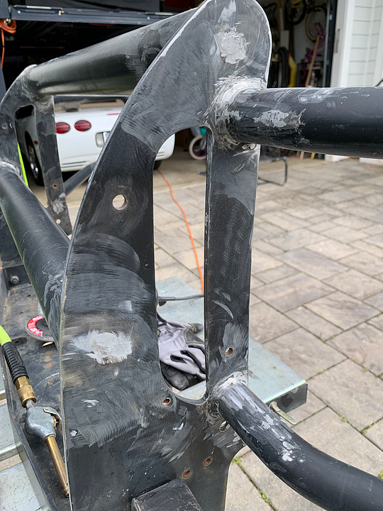

Todays work

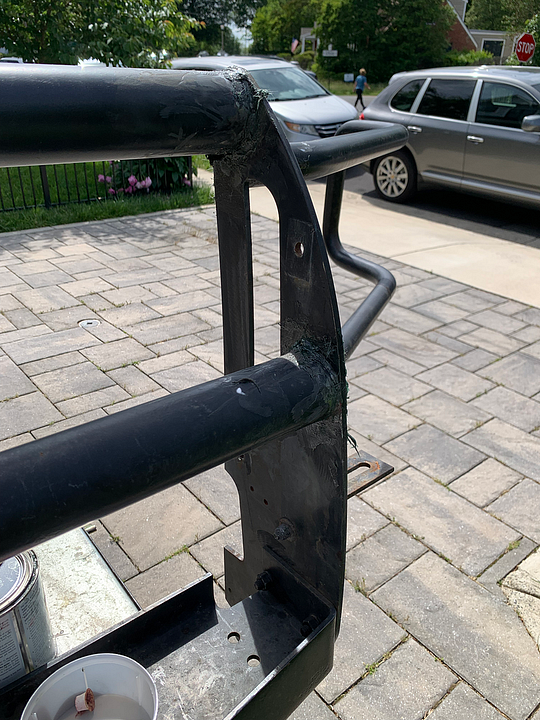

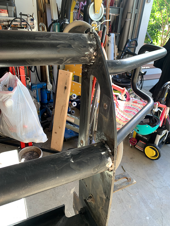

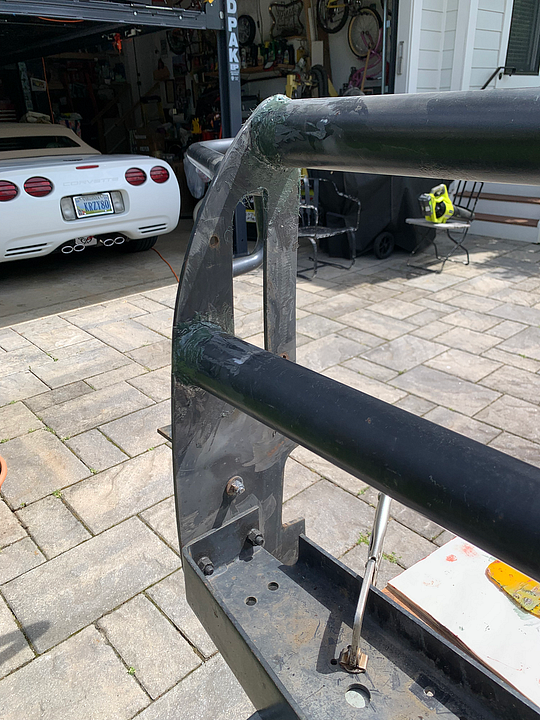

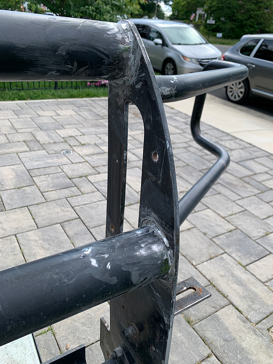

And today we used the grinder and the flap wheel to make everything pretty
I use a fiberglass gorilla hair filler after final grinding then I go over the welds then use the flap wheel to bring it home, it makes for really smooth welded joints and not much of the filler is left after the flap wheel
This still needs the outer tube brackets to be tacked in place in situ, then it gets final paint sanding. And I think the paint is a like a truck bed liner material
These pictures are in reverse order
