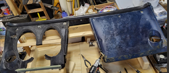

The vents are from a F150 but used on other Ford products also. They are a little bigger, had to enlarge the holes. I got them because you can open/close them with your finger. And they work with the look of the gauges.
So this is what it's like to polish a turd! A month of cutting, fitting, bonding, filling, sanding, sanding, sanding and more sanding.
Next step is to test fit and paint. I'm going to try a matte dark charcoal metallic finish.
Where it started"
...a matte dark charcoal metallic finish.

I'm trying to replicate the look of a 1st gen Camaro dash which is coved out (like the Corvette) but is stamped steel.
OK test fit with the gauges in place. Looks like this is going to work. No real interference issues.
Next is paint. SEM has some matte metallics. I'll have to check them out. Also need to make a support for the center console/gauge area. Also need to come up with something to hide the screw holes at the top of the dash panels.
