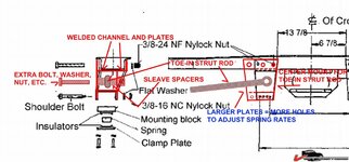

Had a look at the VB&P rear monospring mount for the dual mount setup.
Looks like it will accomodate a rear toe-in adjust strut with a little mod or two to the mounting brackets.
The Vette Brakes set up uses the rear crossmember (diff mount) to locate the monoleaf mounts. I propose making new mounting brackets that could easily accomodate the monoleaf spring - and the struts.
Also, it looks like if you added some larger plates to the fabrication -- more adjustability to the spring rates as well.
This will require me to call them to make sure I don't excede the springs ultimate strength.

I think there is a plate on the inside of the VBP dual mounts that would make it difficult to mount a rod end on the inside. Are you going to run upper and lower control rods and a toe link? If you do this, are you planning on floating the trailing arm pivot?
BBShark -
Yeah - You're Spot-On!
As I looked closer at the catalog (on line) -- there is a web that seperates the forward and aft plates. "Bugger!"
Thats why I'd consider making totally new plates/mounts - that way I could get the space opened for the toe-in adjust. The red box construction (upside down and backwards 4H look) that I've drawn over the left (end-view) in the VB&P diagram is an endview of the new mount drawn over the original. No web to keep the sturt out, and spacers to improve rigidity.
Maybe this will help explain:

2. Toe -In adjust, and,
3. NEAR ZERO camber change!-- the BEST! :yahoo:
4. Lowest possible costs... we'll see.
Thanks Jim, that was my question- the permanent shims to locate the T/A's.
Now you've got me pricing out parts to build a similar setup. :waxer: It seems like if you do the R&D on your own, a pretty nice setup can be had for a few hundred $$ (minus the fancy shocks). Here comes another winter project....
About the Global West arms- The advantage I see with them is that they could be lighter than the vansteel ones. The parking brake cable mount shouldnt interfere as long as you use 17" or 18" wheels.
