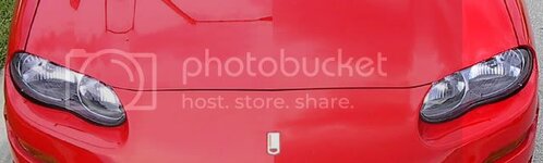

After finishing the writeup i decided to take the car out for a cruise and get some new photos of it. Its not done yet, but she looks good.

TT: Yeah they are tinted using the tint in a can stuff. Spray 9-10 light coats and wetsand. I really wanted everything to either be black, chrome or blue (even the front badge). Now I need to get some LED's out back. The stock bulbs arent nearly bright enough. Any ideas while keeping the stock lenses?

I've used automotive clear with a few drops black to tint headlights as well as taillights. Works great, way better than that rattle can tint - you can even wetsand and buff the lenses just like any other painted surface.
