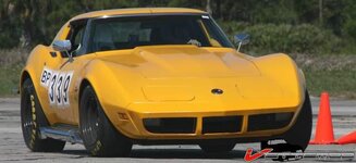

I think I'm going to try the rubber mud flap material
Mine already scraps on curbs and stuff and it's the stock spoiler
I don't drive on the street much at all though, only to bed brakes or to break in new tires
I think I want to move it forward those and get rid of the under side openings
like this
