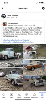

I have a friend who is 16 years old, is on the autism spectrum, and takes forced perspective photographs. What is forced perspective.... every single one of those pictures below is a 1:18 scale model car. I met him 3 years ago at a car show where he was given a 57 Ford 300 - somehow I ended up as his friend friend of the family.... maybe because I drove the FJ40 to the show rather then my C3? We are building a truck that is full size but will look like that one below. It will be easy to drive, reliable, new, and be the vehicle which he drives while he's getting parts for his fleet of vehicles. What vehicles, you might ask. A 57 Studebaker silverhawk, a 57 Ford 300 and now a 59 Buick Electra 4 door (evicta?)

if you're curious about him...
